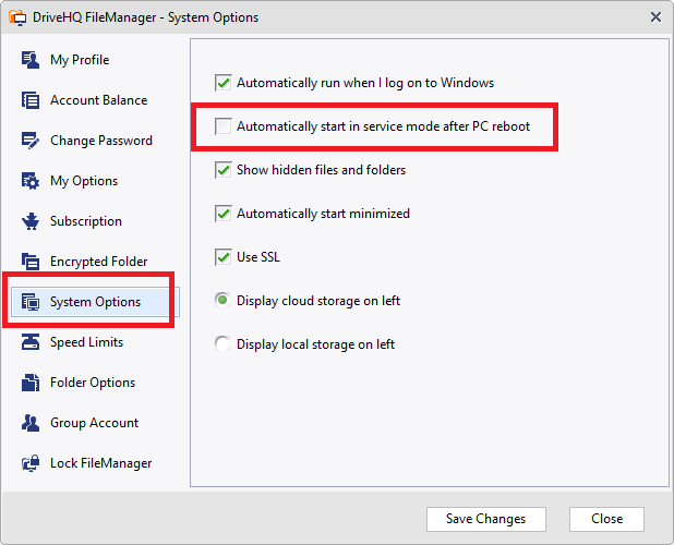

One additional question.  If I use the DriveHQ syncronization feature, do I need to have the DriveHQ FileManager always running?

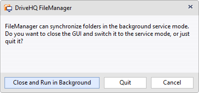

Yes, FileManager needs to be running all the time. If your PC/server is unattended (that nobody is logged on to the PC/server), then FileManager needs to be configured to run in the service mode. You can configure it in Options -> System Options, see the screenshot below: (Check the checkbox of "Automatically start in service mode after PC reboot). You can then quit the GUI mode and run it in the background service mode.

Thanks.  Just wanted to get back to you.  Using DriveHq FileManager Syncronization with the "Real Time" setting works great!!!  Also, I am using a virtual desktop that can be running 24 hours a day so keeping DriveHQ Filemanager always running is no problem.
