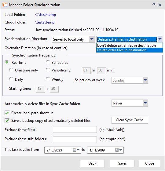

Our engineers have provided a new version.They have not released it to the production site yet. Please download it from:
https://www.drivehq.com/folder/p39750/110545117033.aspx
In this version, they added a new option. Please see the screenshot below. (Click Tools-> Manage Sync Tasks, double click a task to edit it)
After you save the option, you can then try to add a file in the destination (local) folder. It will be automatically deleted in a few seconds. ( Please note the deleted files are kept in the _Sync_Cache_ folder by default. )

 Thanks for the quick solution. I didn't realize that a version with the correction had already been posted.
I did a little test and it seems to work well! I just found a situation, very unusual, in which for some reason the synchronization does not happen as expected. But it is a very unusual case and should not interfere with practical use.
