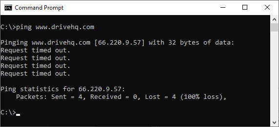

  • (675 posts)
Subject: Re:Unable to connect to 66.22.9.50
Our FTP service works fine. It is monitored 24x7. At any time, we have huge number of concurrent users. Please read our first reply. If you still cannot pinpoint the problem, please email/call DriveHQ customer support directly.
FYI, DriveHQ servers cannot be ping-ed. But it does not affect the service. For example:
Users should have no problem accessing www.DriveHQ.com website.

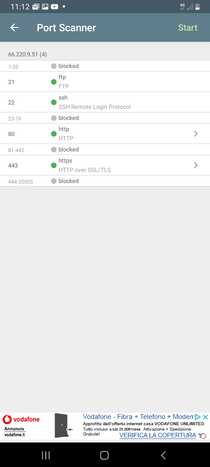

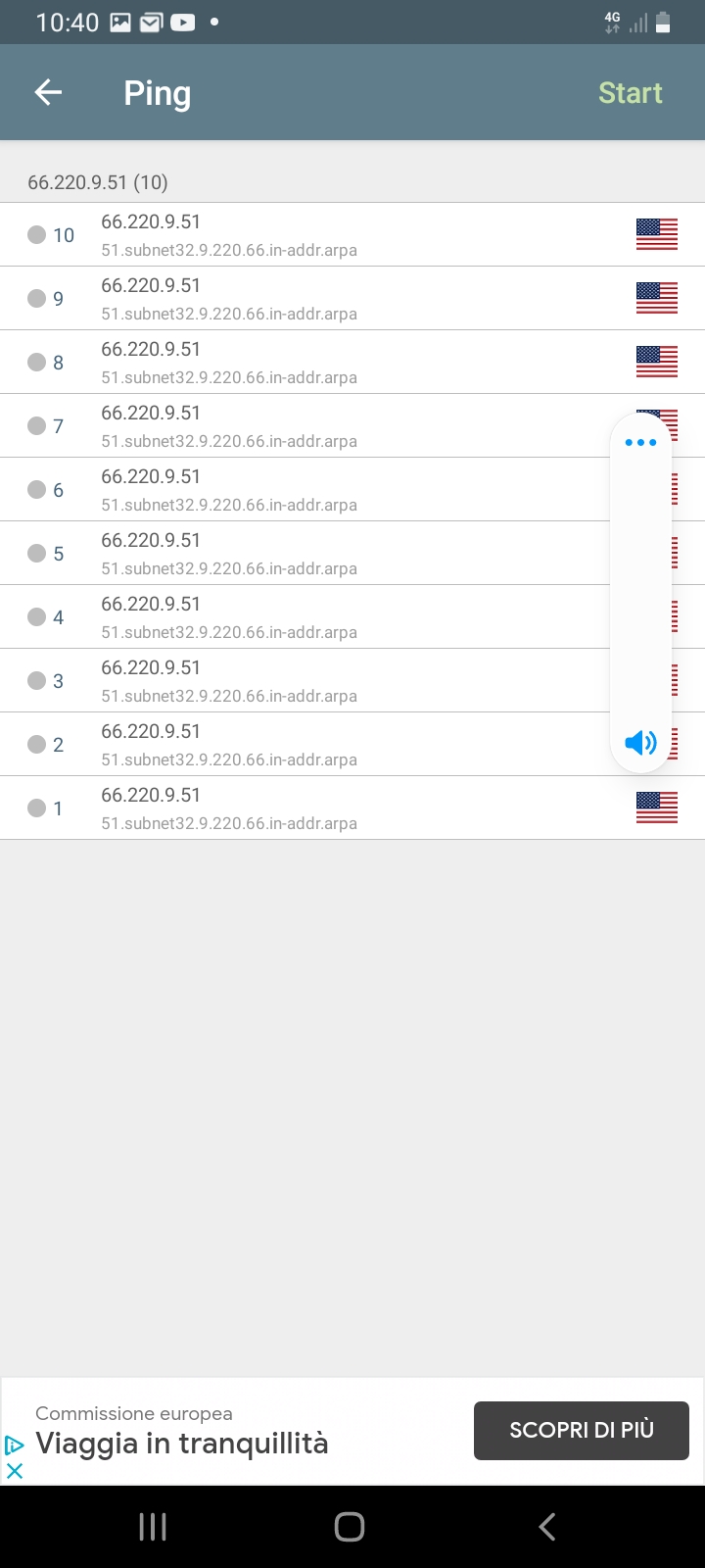

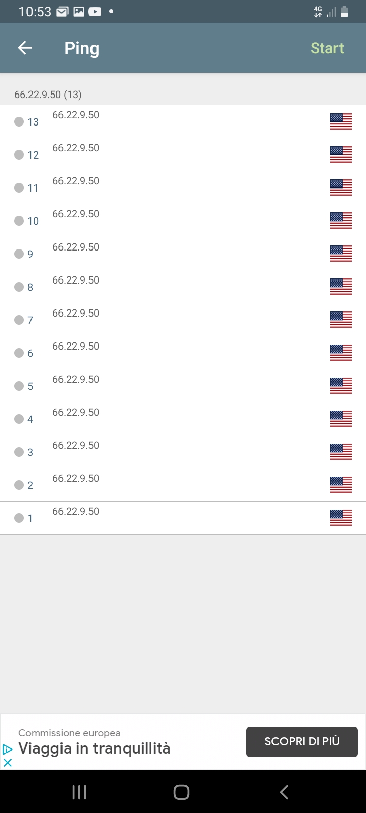

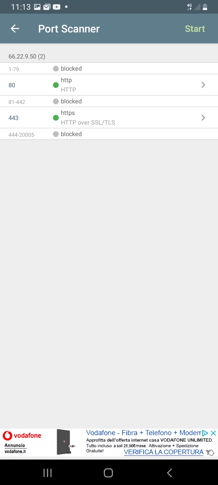

  • cafc_1234
 Hi,
ok, 66.22.9.50 is not pingable. Also 66.220.9.51 is not pingable.
But 66.220.9.51 has the port 21 open, the 66.22.9.50 shows the port 21 closed
why?
emailed to the support 2 days agos without any replay
8/12/2021 1:06:31 AM
  • (675 posts)
 Please use the correct IP address 66.220.9.50 (Not 66.22.9.50)
